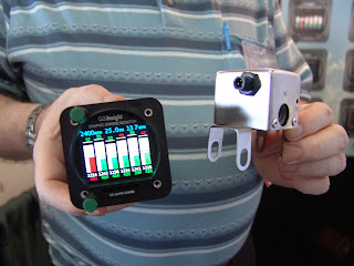

The Grand Rapids Technology EIS was used for checking everything (we haven't yet plugged in the bigger EFIS screens), and it performed with the same aplomb as the one in our Kitfox 4 has done for seven years. I like the simplicity of this box. Hit the master and it is on, flashing for you to acknowledge each probe attachment. Once that is done it sets up ready to reel off all the information you need to get a basic read on your engine health. Magneto checks showed both the rpm drops, as well as the exhaust gas temperature rises across the cylinders. The constant-speed propeller checks showed the rpm drop and subsequent rises as well.
